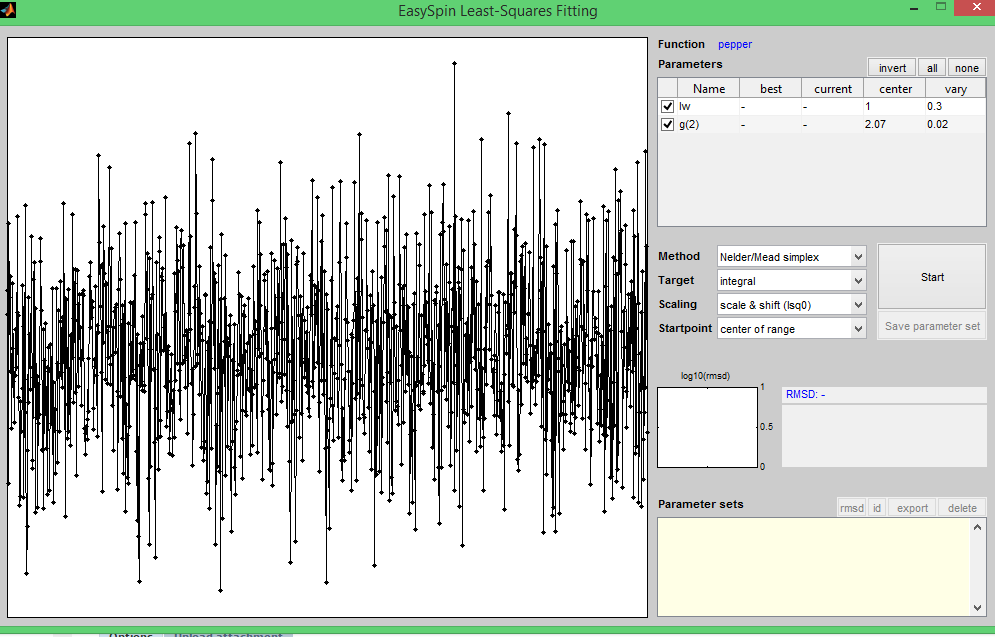

Hi! everyone. I'm trying to fit my experimental result from EPR spectrometer by EasySpin on MatLab. My spectra file were saved in form .DTA and .DSC. So, I wrote MaTLab for analysis this following by the code
[spc,Params,B] = eprload('1KGY1OCT2016.DSC');
spc = addnoise(spc,0.0000000000000000000000000000000000001,'n');
Sys0.g = [1.99, 2.07, 2.11];
Sys0.lw = 1;
Vary.lw = 0.3;
Vary.g = [0 0.02 0];
Vary.lw = 0.3;
Exp.mwFreq = 9.8;
Exp.Range = [200 400];
esfit('pepper',spc,Sys0,Vary,Exp);
The code was typed from Fitting EPR spectra section in website Easyspin http://easyspin.org/documentation/userg ... tting.html. The result from running the code shows as file 11.png.
My fitting pannel
My fitting pannel

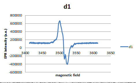

I don't know why it is and think there is some mistakes which occurred in my EPR spectrum or I missed something (may be I have to do noise reduction of the spectrum before insert to fitting code ) in the code. I think if I write the good code, I will get the exact spectrum like this
The real spectrum (horizontal axis has "G" unit).

The syntax of the eprload function is [x,y,Params] = eprload(FileName), so it is possible that you are loading your spectrum in the wrong order, i.e. [y,Params,x] in your example. I don't know whether ES can tell the difference, but you could try [B,spc,Params] = eprload('1KGY1OCT2016.DSC') and see if that does it.

thanasis pointed out the wrong order in loading the file.
Next you use the
addnoise
function with an assumed Signal-to-Noise ratio of 0.0000000000000000000000000000000000001. Is there any particular reason for that?
To perform a fit the structure
Exp
should contain your experimental parameter. At least
range
have to be different from what you posted, but probably also
nPoints
, and
mwFreq
In general the spectrum shown in the fit panel is the EPR spectrum. Note that it is normalized and has no units on the x-axis.
