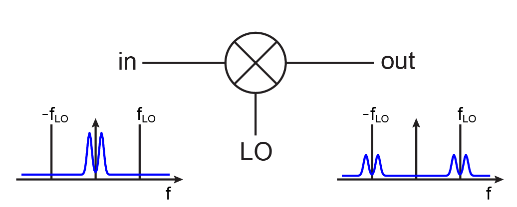

'DSB'

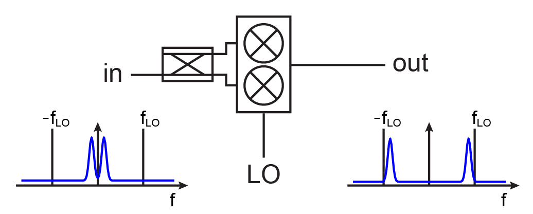

'LSB'

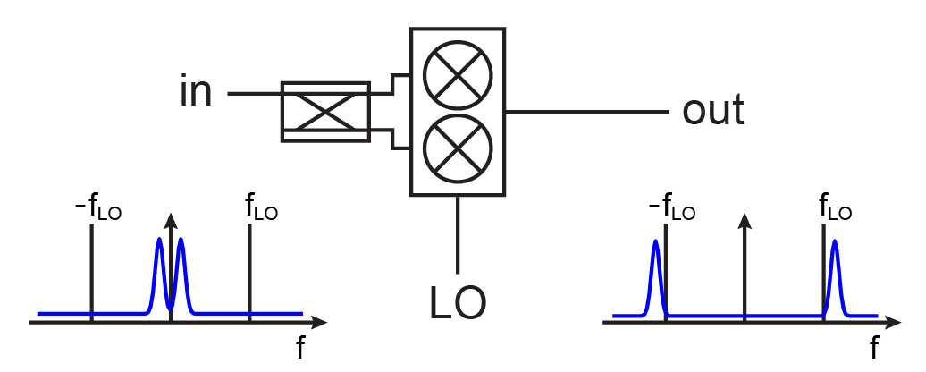

'USB'

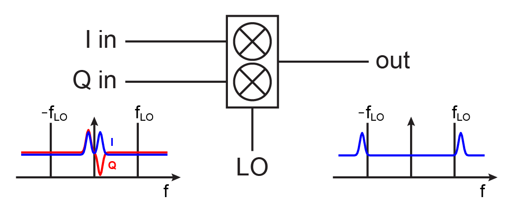

'IQmod'

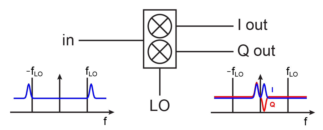

'IQdemod'

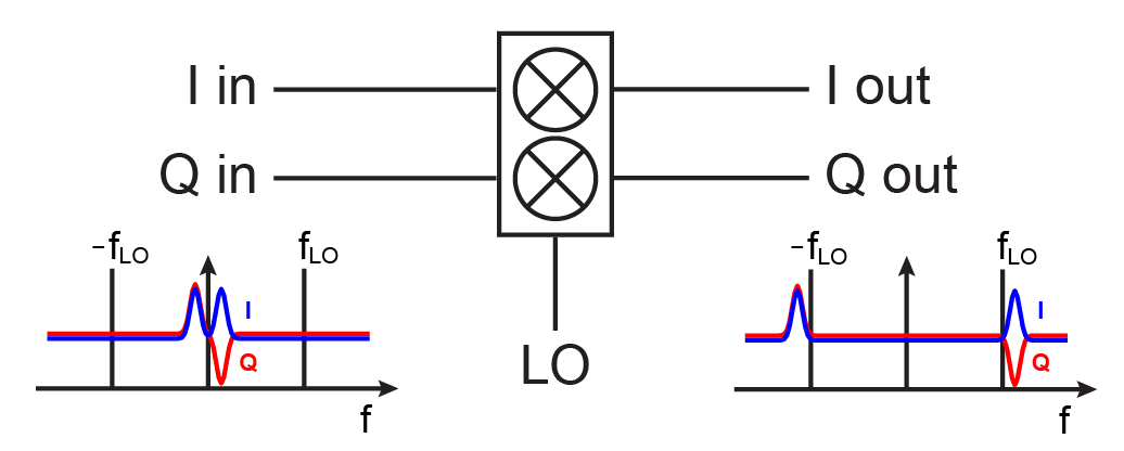

'IQshift'
