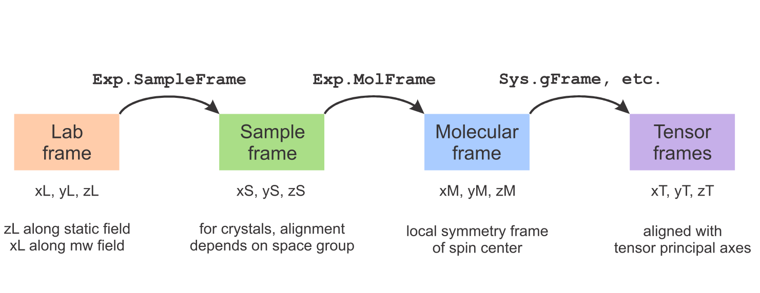

The figure below summarizes EasySpin's frames. There are four frame types: the lab frame, the sample/crystal frame, the molecular frame, and a set of tensor frames (one for each tensor). The orientation of the sample (crystal, film, powder, frozen solution, etc.) in the lab frame is given in Exp.SampleFrame
, the orientation of the paramagnetic molecule in the sample frame is given in Exp.MolFrame
, and the orientations of the various tensors in the molecular frame are given in Sys.gFrame
, Sys.AFrame
, Sys.DFrame
, Sys.QFrame
, Sys.eeFrame
, Sys.nnFrame
, and Sys.DiffFrame
This overview explains at how these frames are defined in EasySpin and shows how you can specify the relative orientations between them. All frames are right-handed cartesian with orthonormal axes.

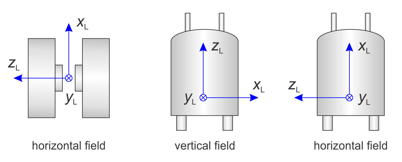

The lab frame L is fixed in the laboratory. Its three unit vectors are denoted xL, yL, zL. EasySpin defines the three axes of the lab frame as follows:
The following figure illustrates this.
By default, the B1 field of the incident microwave excitation is along xL for the standard perpendicular-mode resonators. For parallel-mode resonators, B1 is along zL. You can specify non-standard mirowave excitation geometries using Exp.mwMode
For photoexcited samples, the incident optical excitation beam (from a laser) is assumed to travel along yL by default, which is the common setup used with electromagnets. To specify other laser excitation geometries, use Exp.lightBeam
The sample frame S is a sample-fixed frame with orthonormal unit vectors xS, yS, zS. The sample can be a crystal, a film, a frozen solution, etc.
In the case of a crystal, EasySpin follows the conventions prevalent in X-ray crystallography where the axis convention depends on the space group of the crystal:
For crystal simulations, it is important to be aware of these conventions, as EasySpin relies on them to compute the orientations of all sites in the unit cell of a crystal given the orientation of a site in the asymmetric unit.
For partially ordered samples such as thin films, lipid bilayers and liquid crystals, xS, yS, and zS are arbitrary. One possibility that is often convenient is to define the zS axis to be perpendicular to the plane of the film or bilayer, or along the alignment direction of the liquid crystal.
For powders and frozen solutions, the definition of xS, yS and zS is also arbitrary.
In versions of EasySpin prior to 6, the sample frame was called crystal frame, and the axes were denoted as xC, yC and zC.
The molecular frame M is a reference frame that is fixed in the molecule or paramagnetic center. Its three unit axes are denoted xM, yM, and zM. You are free to choose the orientation of the molecular frame within the molecule, but it is best to follow existing conventions or align it with the local molecular symmetry. For example, put the zM axis along the plane normal of an aromatic radical or a planar transition metal complex. For a nitroxide radical, xM is conventionally along the N-O bond, and zM is perpendicular to the C-NO-C plane.
If you import data from quantum chemistry programs like ORCA, then you can take the frame from those calculations as the molecular frame. All imported atom coordinates and calculated tensors will be defined in this frame. EasySpin can import ORCA calculation results.
Last, there are the tensor frames T, with unit vectors xT, yT, zT. There is one frame for each tensor in the spin Hamiltonian, such as g, A, D, and Q tensors, as well as the rotational diffusion tensor. The tensor frame for a given tensor is its eigenframe. Its axes are aligned with the principal axes of the tensor. The particular order of principal values, and therefore the assignment of the associated principal axes to xT, yT, and zT, is arbitrary and up to you.
