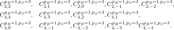

This general spin Hamiltonian can be written as: [eqn] We used the extended Stevens operators [eqn] . The magnetic field is expressed in spherical coordinates [eqn] and [eqn] denote the spherical harmonics. Prefactors Apq and αpB are tabulated in McGavin et al. [eqn] is a Wigner 3-j symbol.Wigner 3j symbols are zero unless qB + qS = q and [eqn]. The parameters describing the spin system are the [eqn]. They are given in units of Energy (Magnetic Field)pB, which correspond in Easyspin to MHz (mT)pB. The allowed coefficients have p an even integer numbers between |pB-pS| and pB+pS and q integer number between -p and +p. For example for pB = 1 and pS = 3 the following coefficients are allowed: [eqn]

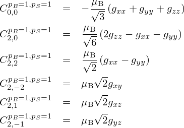

The commonly used Zeeman Hamiltonian is linear in B and S. Usually it is sufficient to describe the interaction with the external magnetic field. [eqn] with symmetric g matrix and the Bohr magneton μB. We can construct now the [eqn] as: [eqn]

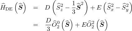

The zero-field terms in the spin Hamiltonian are commonly expressed as: [eqn] However, the most common form which is quadratic in S and consider the diagonal terms in a trace-free representation is: [eqn] The corresponding coefficients should now be transformed to the [eqn] (only p = pS is allowed for pB = 0). With ζ00 = 1 and [eqn] for even pS it is straightforward to transform the coefficients: [eqn] D and E in HDE are converted to [eqn]
