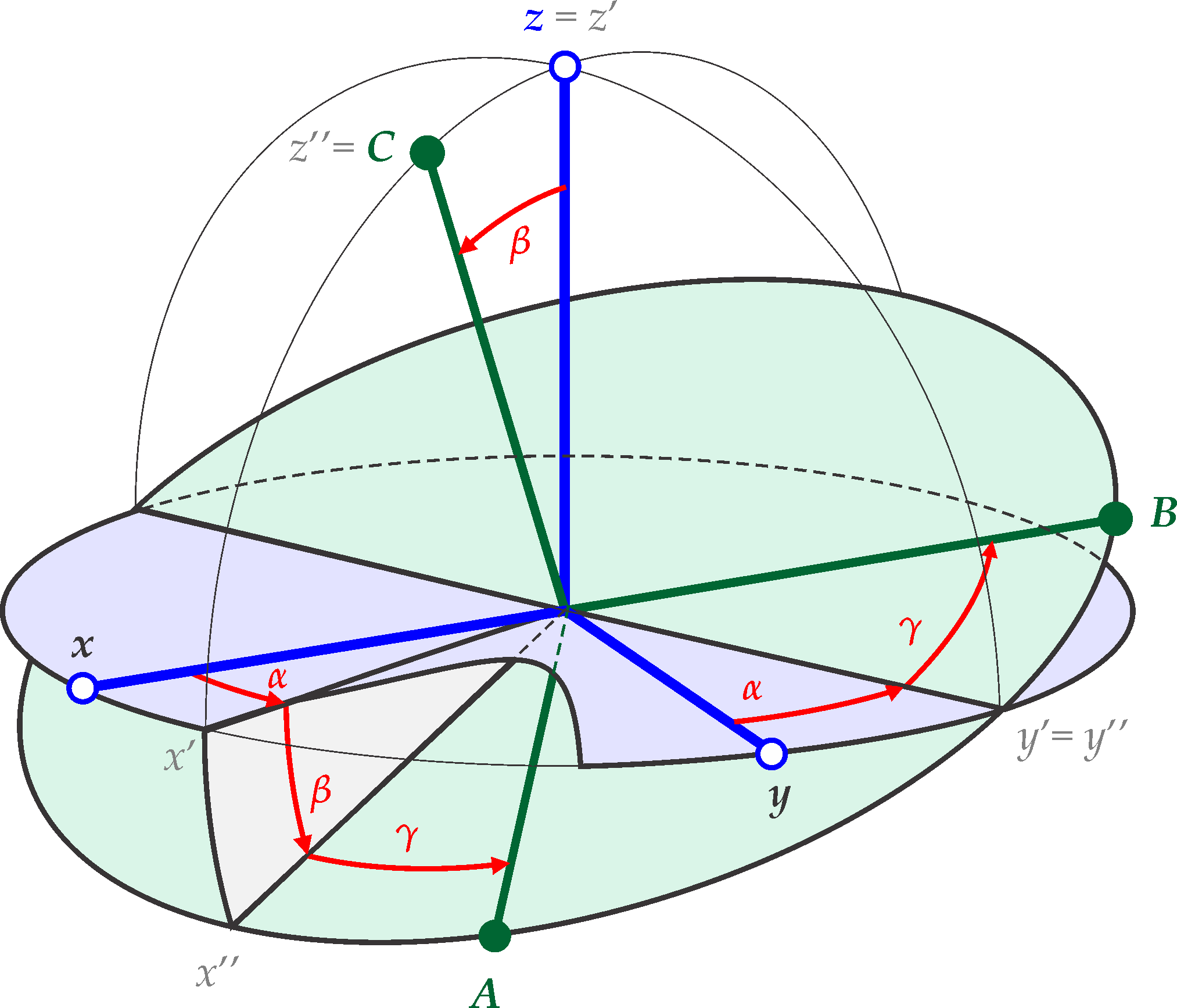

The angles define the relative orientation between xyz and ABC. The angles describe three successive rotations of one coordinate system xyz that align it with the other one, ABC.
  1. Rotate xyz counterclockwise around its z axis by α to give x'y'z'.
  2. Rotate x'y'z' counterclockwise around its y' axis by β to give x''y''z''.
  3. Rotate x''y''z'' counterclockwise around its z'' axis by γ to give the final ABC.
This is called the zyz or y convention, for obvious reasons. It is used in many textbooks:
There exists also a zxz or x convention that is used in fields unrelated to EPR (e.g., classical mechanics).
The z axis is called the vertical, the y' axis (same as the y'' axis) is called the line of nodes, and z'' (same as C) is termed the figure axis.

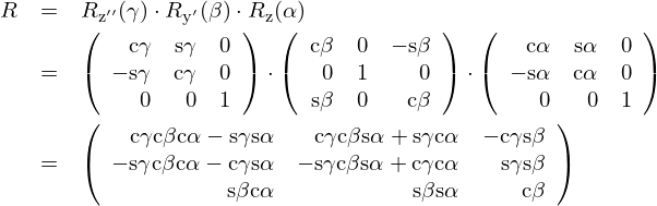

The matrix describing this rotation is a product of 3 matrices describing one single-axis rotation each.
[eqn]
where c and s mean cos() and sin(). Rotation matrices are real and orthogonal, i.e. their inverse is equal to their transpose. The determinant of R is +1.
